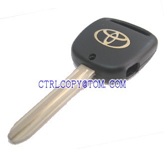

            what do you mean by 2 in 1 unit? meaning the remote is attached to a key?

              biometrics i understand regarding false acceptance/rejection. which is why on laptops i still view it as a gimmick.
              as for RFID, i didnt know the card could be "cloned", i was under the impression that every card was securely coded to a particular station.
              and yes; the remote you are referring to is spot on. better still; if got aftermarket one where the key fold into the remote. it will save my trouser pockets from all the poking.
              as for the camry key; i believe my remote module can be interchanged with the following remotes
              one
              two
              three
              Otherwise the best way to achieve this aim would be to find out where the alarm control box is; and replace. then reprogram the key to the immobiliser
